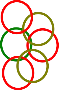

For example, consider the following figure from the Wikipedia page:
The green disk intersects 5 other disks, but its DIN is 3 (the 3 red disks are disjoint). The topmost and bottommost red disks intersect 2 other disks, but they themselves intersect, so their DIN is 1. The yellow disks have a DIN of 2. The greedy algorithm thus selects the topmost or the bottommost red disk.

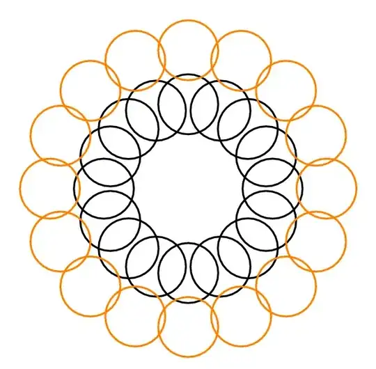

What is the actual maximum minimum DIN in collections of unit-disks?
It is 3.enter image description here

  • There are 32 unit disks here, arranged in 2 levels of 16. Each disk intersects 3 disjoint disks - 2 on its own level and 1 on the other level. But, the greedy algorithm will still find an optimal solution, with 16 disks. – Erel Segal-Halevi Jan 27 '14 at 07:40
  • Yes, that answers only 1/4 of the question :-) – Yury Jan 27 '14 at 15:37
