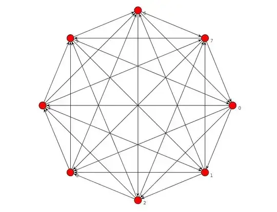

To add a little context, here's a construction for a graph that doesn't have a transitive feedback arc set. For this construction, I'll use the following gadget graph:
gadget graph used to force implications
This tournament has the following properties (which I checked using a program, I didn't prove it formally):
  • if (2,7) is not in a given TFAS, then (1,3) is
  • if (5,1) is in a given TFAS, then so is (3,6)
  • if (7,3) is in a given TFAS, then (5,1) is not
or slightly abusing predicate logic notation:
  • $\neg (2,7) \rightarrow (1,3)$
  • $(5,1) \rightarrow (3,6)$
  • $(7,3) \rightarrow \neg (5,1)$
You'll notice that for each implication, the two edges are pairwise disjoint, so the following construction works:

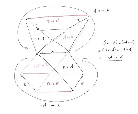

construction for graph that doesn't have a TFAS
I hope you can make out the idea of the graph: using the implication properties of the tournament above, we can construct a graph in which each transitive feedback arc set both includes and doesn't include the edge $A$, i.e. a contradiction, which means the graph doesn't have a transitive feedback arc set. Any completion of that graph cannot have one either since the same contradiction will remain in any completion. I left out a large number of vertices, all of which can be derived from substituting the tournament above for the implications.
G. Bach
  • 431
  • I'm sorry, I don't follow. Is there any reason you can't just post a list of the edges so I can run it through an ASP solver and try to verify it? According to clingo, your gadget graph has 8 different TFAS's. Here's the smallest one: tfas(edge(5,0)) tfas(edge(6,0)) tfas(edge(7,0)) tfas(edge(6,2)) tfas(edge(7,3)) tfas(edge(1,2)) tfas(edge(1,3)) tfas(edge(7,5)) – dspyz Jan 30 '14 at 04:13
  • I just noticed you mentioned the edge (6,3) in the gadget graph, but the image you provided has the edge (3,6) – dspyz Jan 30 '14 at 05:20
  • I figured it out, see my updated answer: http://cstheory.stackexchange.com/a/20778/13643 – dspyz Jan 30 '14 at 06:32
  • @dspyz I thought the construction was clearer than just a list of the edges, since if my reasoning isn't wrong, all that would be required to verify is whether the tournament above the construction actually has those implication properties. Thanks for pointing out the mistake about edge (3,6)! I also got 8 TFAS for that gadget, the one you listed being one of them. – G. Bach Jan 30 '14 at 14:02
  • I'm sorry. I constructed the graph wrong. I fixed it and clingo now reports no TFAS. – dspyz Feb 01 '14 at 19:10
  • @dspyz Thank you very much for putting this much effort into this! I was quite a bit confused since just like you, I couldn't see an error in the construction. At least that bit is settled, then. – G. Bach Feb 01 '14 at 20:02
  • I found one with nine vertices. See the updated answer – dspyz Feb 01 '14 at 22:51
