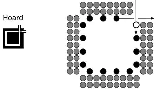

Now we reduce this drawing to an $O(n^2)\times O(n^2)$ board (rotated 45 degrees) with $O(n^2+m)$ black checkers and one white king. We need three types of gadgets: corners, splitters, and hordes. A corner contains two black pieces that can only be captured together by changing the white king's direction. A $k$-splitter contains a single piece that must be captured in a particular direction, with $k$ special locations for the capturing king to jump into. Finally, a hoard is a large box full of $hn$ black pieces that must be captured in a particular order, for some large constant $h$. In the figures below, the gray circles are pieces that cannot be captured.
corner gadget
horizontal 4-splitter gadget
hoard gadget

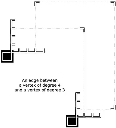

Now replace every vertex of degree $k$ with a hoard, connected to a horizontal $k$-splitter and a vertical $k$-splitter. For each edge $(i,j)$, place constant number of corners aligned with the splitters for hoard $i$ and hoard $j$. It's easy to arrange for the corners for different edges to lie at distinct $x$- and $y$-coordinates. Place the white king inside one of the hoards, in the position shown by the white circle above.
one edge
The white king can capture at least $hn^2+4n$ opposing pieces—every piece in every hoard, plus four additional edge pieces per vertex—if and only if the graph $G$ is Hamiltonian.

  • Very nice. But I do see a couple of problems, one of which my reduction has as well. First, when the king exits a corner, it can stop anywhere, potentially allowing it to enter another corner inappropriately. Second, there's nothing to force the king to return to the initial vertex; it could end on any vertex. Mine has the same problem, but it is easily fixed for either reduction, by adding an appropriate extra piece to capture inside the start vertex. – Bob Hearn Oct 08 '10 at 01:40
  • The second problem is easy to fix: move the starting location for the king deeper inside the horde. – Jeffε Oct 08 '10 at 04:03
  • But the first problem is more serious. I guess we need your crossover gadgets after all. Drat! – Jeffε Oct 08 '10 at 04:04
  • I think removing the exit black piece from the corner gadget, and adding a black piece on every arm of the input splitter for each vertex, might also do the trick. – Bob Hearn Oct 08 '10 at 04:52
