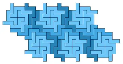

It is unknown whether or not it is decidable to determine if a given shape can tile the plane, even for polyomino tiles.
          Tiling
          (Image from Wikipedia.)
