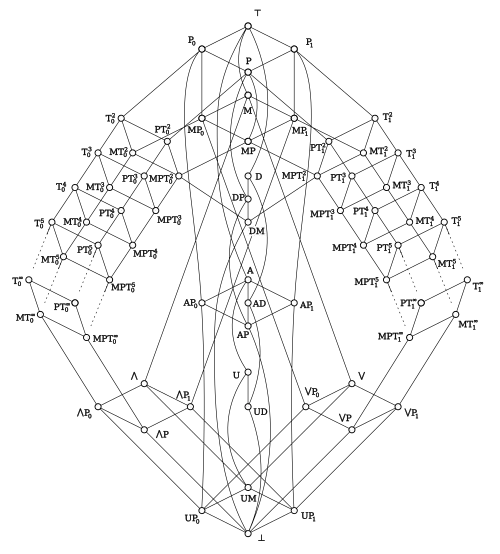

For alphabet size 2 (the Boolean case), the lattice of clones is countably infinite, and is called Post's lattice.
Post's lattice image from Wikipedia
Post's lattice also makes clear why there are only a few interesting bases of operations for the Boolean case.
For alphabet size 3 or greater the lattice of clones is uncountable. Further, the lattice does not satisfy any nontrivial lattice identity, so it seems impossible to provide a complete description of the lattice. For alphabet size 4 or greater the lattice of clones actually contains every finite lattice as a sublattice. So there are infinitely many possibly interesting bases of operations to consider when the alphabet has 3 or more symbols.
