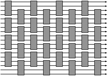

It is possible to sort obliviously with $O(\sqrt{n}\log n)$ calls to the black box, each applied to a contiguous subarray of the original input. The algorithm never touches the input data except through black-box calls. In particular, the same sequence of black-box calls is only a function of $n$, not the actual input data (hence "oblivious").
Here is a sketch of a simpler algorithm, which uses a black box that sorts subarrays of size $k$ instead of just $\sqrt{n}$. The total number of calls to the black box is roughly $2(n/k)^2$. For notational simplicity, assume that $k$ is even and $2n/k$ is an odd integer.
BlockBubbleSort(X[0..n-1], k):
   m = floor(n/k)
   for i = 1 to m
      for j = 0 to m-1
          BlackBoxSort(X[j*k .. (j+1)*k-1])
      for j = 0 to m-1
          BlackBoxSort(X[j*k + k/2 .. (j+1)*k + k/2 - 1])
Here is a diagram of the algorithm for $n=18$ and $k=4$. Data travels from left to right; each box is a $k$-sorter.
As the figure hopefully suggests, this algorithm breaks the input array into chunks of size $k/2$, and then applies bubblesort to the chunks, using the $k$-sorter in place of a compare-exchange operation. Correctness follows by observing that the network correctly sorts any array of 0s and 1s.
As @VinayakPathak's comment suggests, the $O((n/k)^2)$ bound can be reduced by replacing bubblesort with a different sorting network. For example, Batcher's even-odd mergesort reduces the number of black-box calls to $O((n/k)\log^2(n/k)) = O(\sqrt{n}\log^2 n)$, and the AKS sorting network reduces it to $O((n/k)\log (n/k)) = O(\sqrt{n}\log n)$. This last algorithm matches Neal's non-oblivious algorithm up to (large!!) constant factors.

  • +1 for that nice picture! I may be mistaken but it seems to me that it is not entirely correct (correct me if I'm wrong). Assuming the output is in ascending order, if the smallest element is in the last position there is no "path" for it to "travel" to the first position. Changing "for i = 1 to m" to "for i = 1 to m+1" seems to correct this, although it might introduce some unnecessary overhead. – George Mar 20 '13 at 21:22
  • @George Oops, you're right; I need one more layer! – Jeffε Mar 21 '13 at 05:00
