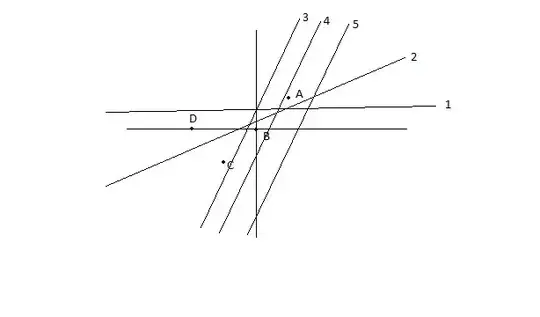

If there is a legal motion, must there be a legal motion where the moving line passes over each point exactly once?
I think the answer is No.

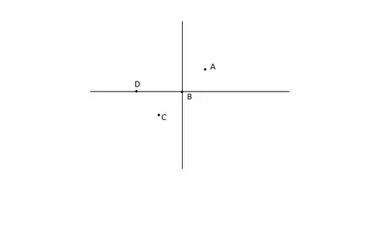

Consider the following points (co-ordinates written in the parantheses) - A(1, 1), B(0, 0), C(-1, -1) and D(-2, 0). Let them have the following weights -
A: +10 B: -100 C: +500 D: -5
Let's describe the current position of the line by specifying the set of points lying above it. Initially, the line is above all the points. Next, the only option for it is to cross A and reach the position {A}. It cannot cross B now because of its very large negatice weight, so the only option is to cross D and reach the position {A, D}. It can still not cross B. However, if it rotates a bit, gets C above it, pushes A below and reaches the state {C, D}, then it will have a very large positive weight above it and so in the next two steps it will be able to cross B and then A and hence reach below all the points.
Therefore even though there is a legal motion, there is none where the line crosses each point exactly once.

Here's a legal motion for the above set of points. Different positions of the line have been marked with numbers increasing in the chronological order. The initial position is not shown, but you can imagine it to be somewhere above all the points. alt text

  • A line of very high positive slope that starts above all of the points and translates downwards will cross C before it crosses any of the other points. – David Eppstein Sep 22 '10 at 04:18
  • Won't it cross D first? Because D is the left-most point in the set? – Vinayak Pathak Sep 22 '10 at 04:25
  • No, this doesn't work. The solution requires the line to pass through either {D} or {A,C,D}, if only instantaneously. But {D} is illegal because D has negative weight, and {A,C,D} is impossible because B is inside the (closed) convex hull of the other three points. – Jeffε Sep 22 '10 at 05:22
  • I don't get your objection. How can it pass through {A, C, D} simultaneously? – Vinayak Pathak Sep 22 '10 at 05:45
  • In case you are saying that a legal motion does not exist, I have added a figure showing the legal motion. – Vinayak Pathak Sep 22 '10 at 05:59
  • I like this small counterexample. – Tsuyoshi Ito Sep 22 '10 at 12:51
    No, this still doesn't work. Please draw the line at the precise moment of transition from position 2 {A,D} to position 3 {C,D}! At that precise moment, the line must pass through both A and C (and therefore also through B), which means it's in position {D}, which is illegal. – Jeffε Sep 22 '10 at 13:16
  • @JeffE: Now I understand your objection. Thanks! – Tsuyoshi Ito Sep 22 '10 at 13:56
  • @Jeff - Yes, it doesn't work. Sorry. – Vinayak Pathak Sep 22 '10 at 14:33
