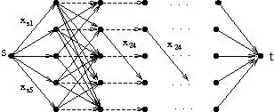

The Bellman-Ford graph
The construction is inspired by the Bellman-Ford$\ast$ dynamic programming algorithm for the single-source all shortest paths problem. Take a DAG $G=(V,E)$ with $n^2+2$ vertices arranged into $n+2$ layers. The first (resp. last) layer consists of one vertex $s$ (resp. $t$), corresponding to the vertex $0$ (resp. $n+1$) of $K_n$. Each middle layer consists of $n$ vertices which are the copies of the vertices $\{1,\ldots,n\}$ of $K_n$. There is a directed edge from each $u_i$ on one layer to each vertex $v_j$ on the next layer. The edge $(u_i,v_j)$ with $i\neq j$ is labeled by the edge $\{i,j\}$ of $K_n$ (or by its length $x_{ij}$). The edges $(u_i,v_i)$ joining two copies of the same vertex of $K_n$ are unlabeled. Then paths from $s$ to the vertices on the $k$-th layer represent all paths of length at most $k$ from $0$ to all the vertices $1,\ldots,n$ in $K_n$. The obtained graph is in fact the subproblem graph of Bellman-Ford algorithm: if we let unlabeled edges in $G$ to have length $0$, then the minimum length of an $s$-$t$ path in $G$ is exactly the minimum length of an $s$-$t$ path in $K_n$ (under the lengths-assignment $x_{ij}$).
Question:   Does $f(n)=\Omega(n^3)$?

  • Under a "DAG representing K_n" I meant a monotone switching-and-rectifier network over the (min,+) semiring. I've suggested one "DP like" model here. Although the network of Bellman-Ford has this "noded = subproblems" property, it does not need to be present in general networks. Bellman-Ford's network (1st picture above) has this property, and actually considers all walks (not just paths). In the meanwhile, we have shown that the Bellman-Ford's network is optimal. – Stasys Feb 15 '20 at 10:42
