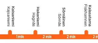

Motivation: a boring metro trip, and a poster that shows the "locations" of the stations at the resolution of one minute of travelling time. Here we are minimising the error that people make if they use the poster to look up the travelling time between stations $i$ and $j$, averaging over all pairs $i<j$.
route map
(source)
For example, here we can read the following approximations of the pairwise distances between the four stations (using A, B, C, D for brevity):
  • A–B ≈ 1 minute, B–C ≈ 2 minutes, C–D ≈ 2 minutes
  • A–C ≈ 3 minutes, B–D ≈ 4 minutes
  • A–D ≈ 5 minutes
Is this the best possible approximation? If you knew the actual travelling times, could you find a better solution?
At first, this sounded like a simple exercise in dynamic programming, but now it seems that some amount of actual thinking is required.
Does anyone recognise this problem? Or see a clever algorithm for solving it?
