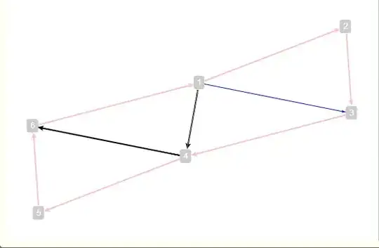

The problem
My company have several units accross the country.
We offered to employees the possibility to work on another unit. But there is a condition: The total number of workers on a unit cannot change.
That means: We'll allow a employee to left his unit if someone wants his place.
Example (ficticious) request data:
Name            Origin    Destination
Maria              1  ->  2
Marcos             2  ->  3
Jones              3  ->  4
Terry              4  ->  5
Joe                5  ->  6
Rodrigo            6  ->  1
Barbara            6  ->  1
Marylin            1  ->  4
Brown              4  ->  6
Benjamin           1  ->  3
Lucas              4  ->  1
The above, plotted: Visualization of the above data
See how we have to choose between the red, blue or black options?
The real problem is a little more complex, because we have 27 units and 751 requests. Please take a look at the visualization
The goal
Having collected all the requests, how to satisfy most of them?
Theory(?) application
Having graph $G(V, E)$, let every unit be a vertex $V$ and a request be a directed edge $E$, a successful exchange will take the form of a directed cyle.
Each cycle must use $E$ only once (a worker cannot leave his unit twice), but can visit $V$ several times (a unit can have many workers wanting to leave).
The question
If this problem is expressed as
"How to find the cycles which, together, involve the biggest number of non-shared edges in a directed graph"?
Will we satisfy most of the requesters?
That being true, there is an algorithm to find that optimal set of cycles?
Will this greddy approach solve the problem?
  1. Find the biggest directed cycle on $G$;
  2. Remove it's edges from $G$;
  3. Repeat 1 until there is not a directed cycle on $G$;
Can you help me?
Do you know another way to describe the original problem (making most of requesters happy)?
Edit: changed department to unit, to better describe the problem.

  • So you want to find as many disjoint cycles in a graph as possible ? – Suresh Venkat Apr 15 '12 at 06:12
  • Well, not sure about nomeclature. But what I need to do here is do the biggest number os exchanges. Which, for me, seems to translate to: find the cycles which, togheter, involve most edges. – motobói Apr 15 '12 at 07:12
    Are you sure that you just want to avoid using the same edge more than once? From your description of the application, it looks to me that you should avoid using the same vertex more than once, which is a stronger condition. – Tsuyoshi Ito Apr 15 '12 at 12:51
  • Each edge represents a exchange requested by an employee. So, seems possible that two vertices are in two distinct cycles. – motobói Apr 15 '12 at 14:36
    @TsuyoshiIto: As I understand from the description, the condition is that at each vertex the indegree should be equal to the outdegree. So, vertex-disjointness is not needed. – Yoshio Okamoto Apr 15 '12 at 15:55
    By the way, if my understanding is correct, the problem should be solvable in polynomial time by means of network flow. Namely, if we give a unit of profit for a unit of flow along an edge, and we give a unit capacity on each edge, the problem is to find a circulation of maximum profit. – Yoshio Okamoto Apr 15 '12 at 16:15
    This post discusses a generalization of your problem http://okasaki.blogspot.co.uk/2008/03/what-heck-is-math-trade.html (think of each person as having one item to trade, namely their job placement). – Radu GRIGore Apr 15 '12 at 19:50
  • I wish I could press up a thousand times, @RaduGRIGore. – motobói Apr 15 '12 at 20:32
  • the blog post mentions this software trademaximizer by okasaki. wonder what algorithm it actually uses? scanning the site does not seem to turn up an answer. maybe in the source code... – vzn Apr 16 '12 at 04:13
  • motobói, @Yoshio: Oops, I misinterpreted the diagram. Now I agree that vertex-disjointness is not needed. Thanks. – Tsuyoshi Ito Apr 16 '12 at 13:33
  • rough take on formulating/modeeling this (correct me if Im wrong). depts are sets of empls. empls currently belong to a single dept ie dept membership is disjoint. empls record requests to transfer to other depts. not all empls have requested transfers. problem: create a "shuffling" (permutation of some subset of all employees that have requests) that maximizes the total # of fulfilled requests. – vzn Apr 16 '12 at 15:09
  • another idea for visualizing this: its similar to the "musical chairs" game across departments except that a chair is not removed and multiple cycles (or "subgames") are involved. the algorithm must try to find the biggest "subgames". the idea of permutations is not so relevant because people only move one "chair" at a time. however, presumably the algorithm is rerun periodically ie requests continue to come in after the last reordering. – vzn Apr 16 '12 at 15:31
    Awesome question, makes us feels like what we do can really be used in real life :). – Gopi Apr 16 '12 at 16:15
  • I have edited to clarify the question. – motobói Apr 16 '12 at 17:54
  • @motobói: The update is much clearer, except the question "See how we have to choose between the red, blue, and black options?" No, I don't see. Only the red option is a cycle; the blue and black options are just paths; moving employees along a path reduces the number at one end and increases the number at the other, violating the constraint that the number of employees at each department must not change. (Are some edges in your figure meant to have multiple colors?) – Jeffε Apr 16 '12 at 20:59
  • @motobói this is irrelevant to your question but I hope you can help. Now I am looking for visualization tools that can draw huge directed graph (with no. of edges is up to millions). I notice that you use arborjs for the visualization. Can it serve my purpose? Are you aware of any alternatives, thanks. – sma Apr 16 '12 at 21:35
  • See this Stackoverflow thread, @pegausbupt: http://stackoverflow.com/questions/7034/graph-visualization-code-in-javascript – motobói Apr 16 '12 at 23:00
    @Gopi, a problem that is even more general than the one TradeMaximizer solves (you also have a bound on cycle length) is used to find transplant donors and actually save lives. – Radu GRIGore Apr 17 '12 at 08:10
