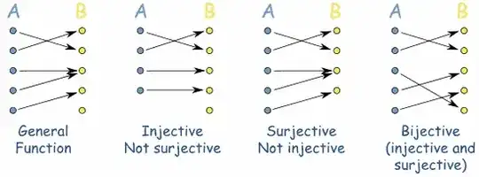

First of all I believe that this algorithm/function is bijective, which means it is deterministic and one member of $A$ has only one correspondent member of $B$ and vice-versa:
Another peculiarity is that input and output domains are exactly the same so, following the above example, $A$ = $B$ = $D$ with $D$ being a range from $m$ to $n$.
