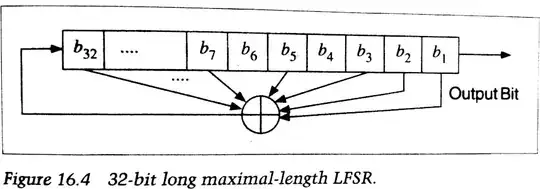

In the classic book "Applied Cryptography" (20th anniversary edition) from Bruce Schneier, there is an illustration of a maximal-length LFSR:
32-bit long maximal-length LFSR
According to the book, this LFSR uses the tap sequence from the polynomial $x^{32}+x^7+x^5+x^3+x^2+x+1$ which is maximal-length.
However, most examples I found online (e.g. Wikipedia) increment the numbering of the shift register bits from the input to the output (left to right)—which could just be a different convention—but the taps are also reversed. On this figure that would translate to taps on $\{b_1,b_{26},b_{28},b_{30},b_{31},b_{32}\}$.
I would normally tend to trust a reference book more than random online sources, but I found an alarming number of counterexamples. Are the taps placed correctly on the figure above?

Are the taps placed correctly on the above figure?
No. That's acknowledged in the errata to the second edition, on the section for page 375 (AFAIK the 20th anniversary edition is essentially the second edition with a little extra at the beginning).
My preferred method to determine the hardware implementation for a Fibonacci LFSR from the polynomial:
  • Use a shift register with as many bits as the degree of the polynomial.
  • Number shift register state bits (the output of the internal D gates) from $0$ for the output, to $n-1$; with thus $n$ the input of the shift register.
  • XOR the bits $i$ from $0$ to $n-1$ of the shift register that has their term $x^i$ present in the polynomial¹ ($x^0$ is the term $1$ of the polynomial).
  • For an LFSR in scrambler configuration, additionally XOR the input of the scrambler.
  • Feed the result of the XORs to the input of the shift register.
Depending on convention, the taps shown are for polynomial $x^{32}+x^{31}+x^6+x^4+x^2+x+1$ or it's reflected polynomial $x^{32}+x^{31}+x^{30}+x^{28}+x^{26}+x+1$. These are not primitive², and accordingly, the sequence for the LFSR shown is not maximal-length.

² Proof: every primitive polynomial is irreducible, and $x^{32}+x^{31}+x^6+x^4+x^2+x+1$ is not, since it's divisible by $x^{14}+x^{13}+x^{12}+x^{11}+x^{10}+x^9+x^4+x^3+1$. A polynomial and its reflection have the same status w.r.t. primitiveness and irreducibility.
