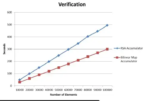

I am trying to understand what is the cost of non-membership verification for a universal accumulator?
More specifically, how can I compute it?
Whether using an accumulator is more efficient than the Merkle Hash tree?

  • @ AleksanderRas I wonder the verification costs. Above two graphs one is constant one is linear, which one is correct. Its verification size o(1), is that true – jhdm Mar 23 '20 at 11:09
  • Where are those graphs taken from? – Maeher Mar 25 '20 at 09:58
  • @Maeher It is taken from "Real-World Performance of Cryptographic Accumulators" study – jhdm Mar 26 '20 at 13:34
  • You seem to be misunderstanding what those graphs are showing. The first one shows how verification time scales with growing size of the accumulated set when run on 8 cores. The second shows how much additional cores help to speed up verification for a set of size 10.000. It turns out they don't really help at all. – Maeher Mar 26 '20 at 13:57
  • @Maeher So can i say rsa accumulator's verification cost is O(1) for exclusion testing – jhdm Mar 31 '20 at 07:59
  • No, since it quite clearly grows linearly with the number of accumulated elements. But you should also not try to reverse engineer the asymptotic runtime complexity of an algorithm from a graph depicting actual runtime for some range of inputs. The two are only weakly related. – Maeher Mar 31 '20 at 08:10
  • @István András Seres @ Maeher says verification cost is O(1) but reating the batched proof is o(n). According to this, rsa accumulator is faster verification cost compared to merkle tree for exclusion proof. Am i right? – jhdm Apr 01 '20 at 09:11
  • @Maeher According to figure rsa accumulator verification cost seems linearly but it should be o(1) – jhdm Apr 18 '20 at 21:41
  • @Maeher What should be verification cost ı dont understand because its update cost o(1) – jhdm Apr 19 '20 at 16:44

  • @ István András Seres I added an image for my previous question. I just want to know which one is more efficient about merkle hash tree or rsa accumulator which is supporting nonmember testing. Verification cost is o(1) for accumulator,isn't it – jhdm Mar 23 '20 at 09:03
  • The study you cite was published in 2013. Back then they did not know batched RSA non-membership proofs, hence your confusion. Batched RSA non-membership proofs are quite a recent result. – István András Seres Mar 23 '20 at 10:13
