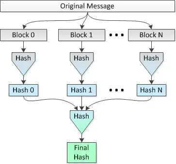

The idea is to hash multiple 1 MB blocks of the file in parallel on 8 CPUs and then hash the concatenated hashes into a single final hash. Let's call this Method 2, show below:
I would like to know if this idea is sound and how much "security" is lost (in terms of collisions being more probable) vs doing a single hash over the span of the entire file.

Using the parallel hashing (i.e., Method 2), I would break the file into 32,768 blocks of 1 MB, hash those blocks using SHA-256 into 32,768 hashes of 256 bits (32 bytes), concatenate the hashes and do a final hash of the resultant concatenated 1,048,576 byte data set to get my final 256-bit hash for the entire file.
Is Method 2 any less secure than Method 1, in terms of collisions being more possible and/or probable? Perhaps I should rephrase this question as: Does Method 2 make it easier for an attacker to create a file that hashes to the same hash value as the original file, except of course for the trivial fact that a brute force attack would be cheaper since the hash can be calculated in parallel on N cpus?
Update: I have just discovered that my construction in Method 2 is very similar to the notion of a hash list. However the Wikipedia article referenced by the link in the preceding sentence does not go into detail about a hash list's superiority or inferiority with regard to the chance of collisions as compared to Method 1, a plain old hashing of the file, when only the top hash of the hash list is used.

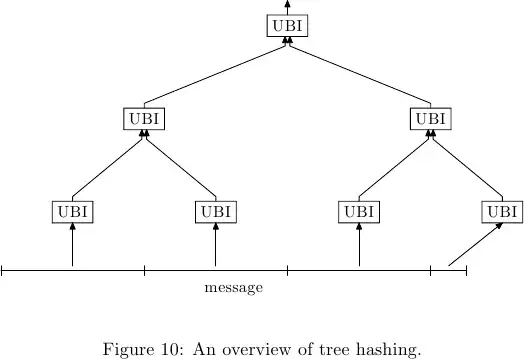

If you want to use Skein (one of the SHA-3 candidates) anyway: it has a "mode of operation" (configuration variant) for tree hashing, which works just like your method 2.
It does this internally of the operation, as multiple calls of UBI on the individual blocks. This is described in section 3.5.6 of the Skein specification paper (version 1.3).
skein tree hash example - from the paper
You will need a leaf-size of 1 MB (so, Y_l = 14, for the 512-bit variant, 15 for 256, 13 for 1024) and a maximum tree height Y_m = 2 for your application. (The image shows an example with Y_m >= 3.)
The paper does not really include any cryptographic analysis of the tree hashing mode, but the fact that it is included (and even mentioned as a possible use for password hashing) seems to mean that the authors consider it at least as save as the "standard" sequential mode. (It is also not mentioned at all in the proof paper.)
