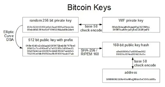

When creating a Bitcoin account, you need to issue a couple of private/public ECDSA keys. Then, you derive your account address by taking a 160-bit hash (through SHA-256 and RIPEMD) of the public key and use a custom Base 58 algorithm to convert it to alphanumeric values (see the picture below, I took it from this page).
Computing Bitcoin Keys
My question is that collisions might happen (not necessarily malicious ones, but incidental ones). I would like to know whether there is a specific mechanism in the Bitcoin protocol to sort out these collisions and be ensured that the payment is going to the right place.
