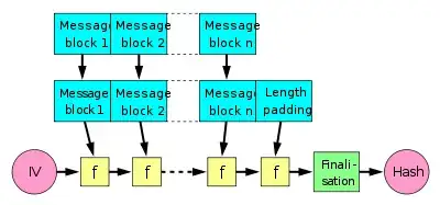

The difference is: All SHA-0, 1 & 2 and MD5 come under a class of algorithm called Merkle–Damgård construction, while SHA-3 falls under Sponge functions.
Merkle–Damgård construction is a method of building collision-resistant cryptographic hash functions from collision-resistant one-way compression functions. Merkle–Damgård construction

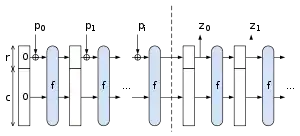

And, Sponge functions are a class of algorithms with finite internal state that take an input bit stream of any length and produce an output bit stream of any desired length.
Sponge Function
