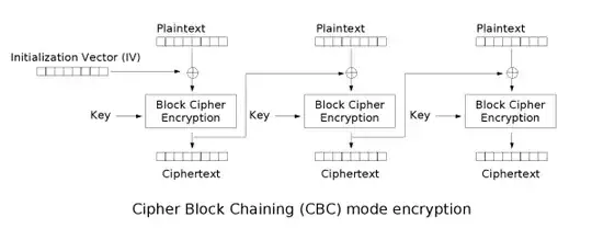

- CBC mode is short for cipher block chaining. You have an initialization vector which you XOR the first block of plaintext against. You then encrypt that block of plaintext. The next block of plaintext is xor'd against the last encrypted block before you encrypt this block.
