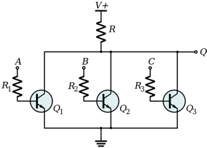

Multi-transistor RTL NOR gate
zaph
  • 917
  • In your 3rd point, you mean that constructing XOR with NAND and NOR is easier, as compared to constructing XNOR? – Haris Mar 26 '18 at 19:23
  • Missing: processors do generally not implement XNOR and there is no advantage over XOR... – Maarten Bodewes Mar 26 '18 at 21:28
  • By hardware I am going back to ~1960 and RTL where there was a pull doe transistor and a resistor. For a NOR if either input went high a transistor conducted and pulled down the output, a natural NOR. See Multi-transistor RTL NOR gate. Sadly I was designing circuits with these and this is the logic that flew to the Moon on Apollo. – zaph Mar 26 '18 at 22:12

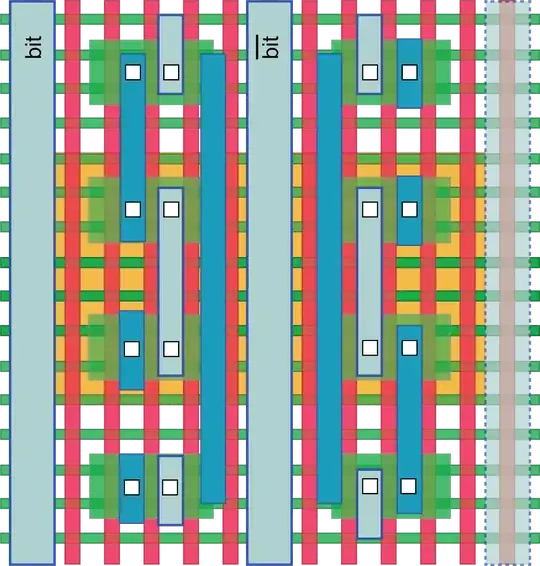

fgrieu's mathematical assumptions I believe to be correct, but the I have issues with everyone's hardware answers. When you make hardware, you are actually good at passing around $\mathbb{s}$ and $\bar{\mathbb{s}}$. I do not believe that it matters too much from the circuit side as I will give you whatever you want, and it's just a matter of the algorithm designer's preference from the cryptographic side. Also, considering modern CPUs, you are wasting so much power on fairyland items in software, a single transistors doesn't matter unless you are doing speciality things. When I do passively powered RFID ICs, I count every transistor, but when I make a processor, I really just am trying to get to tapeout.
There's a lot of XNORs in hardware. When I make circuits, I generally use mirror circuit architectures, which means that NAND, XNOR, etc, all take 8 transistors on aggressive nodes. Due to the mirror architecture, I get an inverted output, and you are forced into this architecture due to lithographic constraints. Attached is an image of the XNOR that was used on a 14nm implementation of the Simon Cipher.
The red are the polysilicon control lines over the green fins on a commercially available FinFet process at 14nm. The blues are my colored metal 1.
In summary, it's just up to the preference of the algorithm designer how they prefer things to be specified, but I'm going to make whatever works best for the logic.
