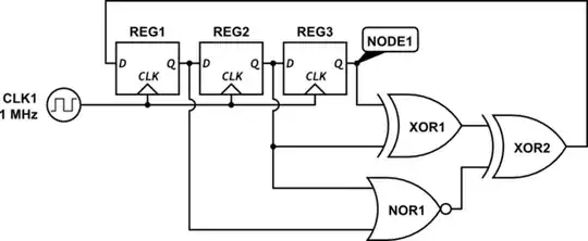

Given that, a de Bruijn Sequence of length $2^n$ is obtained from any m-sequence of length $2^n-1$ (that is, the cyclic output of a LFSR with a primitive polynomial of degree $n$ starting from a non-zero state) by inserting a single 0 in the single subsequence with $n-1$ consecutive 0.
Update per comment: We can implement a circuit that outputs a de Bruijn Sequence of length $2^n$ using $n$ D-type flip-flops connected as for a maximal-length Fibonacci LFSR with $n$ stages, by adding an additional XOR term equal to the NOR of the outputs of the $n-1$ flip-flops on the feedback's side. In the following drawing (which outputs the example sequence above), the added gates are NOR1 and XOR2.
schematic
Note 0: When the number of stages $n$ gets large, the NOR gate with $n-1$ inputs gets annoying; one can trade this for a $\lceil\log_2(n)\rceil$-bit counter with reset, counting the number of consecutive zeroes in the output, giving a $1$ when reaching $n-1$ consecutive zeroes, and that output the additional XOR term.

  • A feedback function with a 62 input NOR gate is going to be way too slow for my purposes :-( – William Hird Apr 08 '14 at 18:00
  • @William Hird: FOUR options: A) using a LFSR, see note 2; B) Just do it: with seventeen 4-inputs NOR gates and four 4-input NAND gates you make a 64-inputs NOR gate with only 3 of the lowest delays logic offers (perhaps 84 CMOS pairs); C) the counter trick of note 0, but its main purpose is to lower the transistor count when using MANY stages. Oh, BTW, 63 stages is not cryptographically strong, I'm afraid. D) Or get away of the ASG, use Trivium; its uses much less gates than the ASG, and has no long propagation delay. – fgrieu Apr 08 '14 at 19:06
