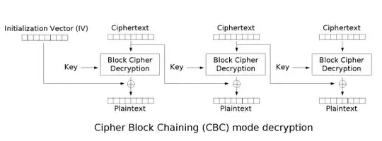

With CBC (Cipher block chaining) mode, before encryption, each block is XOR-ed with the ciphertext of the previous block, to randomize the input to the block cipher (and avoid encrypting the same block twice with the same key, as this would give the same output, and tell the attacker something about the plaintext). As the first block has no previous block, here the initialization vector will be used instead.
On decryption, we will apply the block cipher to each ciphertext block, and then XOR the result with the previous ciphertext block (or the initialization vector, for the first block).
As all ciphertext blocks are known, and we have the key, we can reliably decrypt everything other than the first block, even if no or a wrong initialization vector is given.
For the first block, we actually have no information at all, without the initialization vector, other than that it has the same length as any other block (16 bytes for AES): Every 16-bytes plaintext can be reached by supplying the fitting IV. Fortunately (or unfortunately, depending of your point of view), in many file formats the first some bytes are fixed (or almost fixed, or can be guessed based on the rest of the file).
So, with CBC-mode, a secret initialization vector gives almost no protection, if the key is known to the attacker.
This applies generally: Protocols rely on the key being secret, while an initialization vector can usually be public, and often is even transmitted together with the ciphertext.

Yes, you can, but you might not be able to decrypt the first block if you don't know the IV.
CBC encryption encrypts block-by-block, using the previous ciphertext XOR'ed with the current plaintext block as input of the block cipher, the result of which form the ciphertext blocks.
So you can decrypt each block by performing the block decrypt, and then XOR-ing with the previous ciphertext block, giving you a plaintext block.
This can be performed for each block, with the possible exception of the first block, for which you need the IV. If you don't know you can try and guess the IV. If the result of the decryption already looks like plaintext then the IV is probably all zeros.
If you cannot find out any information about the IV then you're out of luck for the first block of plaintext. The reason for this is that the IV then acts as the key stream of a one-time-pad. And a one-time-pad is fully secure in a information-theoretical sense.
AES always has a block size of 16 bytes, which means that the first 16 bytes of the encrypted message might remain secret.
Note that it is quite common to prefix the IV to the ciphertext. If you cannot read the initial 16 bytes (assuming AES) then it might well be that the first 16 bytes are the IV and that the plaintext starts at the second block.
