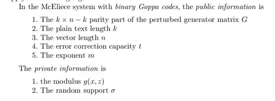

Is my assumption wrong, that S is not available,because if I store the transformation of G to systematic form encoded in a Matrix S then I can calculate m BUT in the whitepaper they do not store the matrix S
for reference: In the whitepaper it says private and public keys in mceliece
