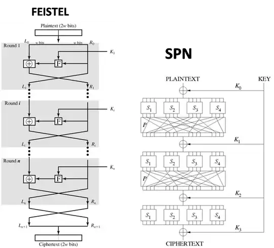

The simple answer is "Because its an SPN cipher".
What is difference between Feistel and SPN?
SPN operates on whole data in one round, where as Feistel divides data into N parts where N>=2 , then operate upon X parts where 0
FEISTEL vs SPN
Image Sources: FEISTEL, SPN
In balanced, data is divided in Two parts i.e N = 2, and X=1 (example is camellia cipher) In Unbalanced, data is divided in more than two parts, i.e N > 2, (example is SMS4 cipher)
Now talking about invertible issue.
SPN has to be invertible, otherwise decryption will not be possible. where as in Feistel cipher, the F function can be invertible or non-invertible. And you will still be able to get encryption and decryption.
Another beauty of Feistel Cipher is that code for Encryption and Decryption is same, you only need to use the round keys in reverse order. (even if your F function is invertible, you need not to write its inversion in the code)
One more point to note is, in Feistel your F function can be a simple SPN.
