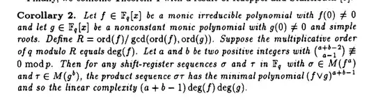

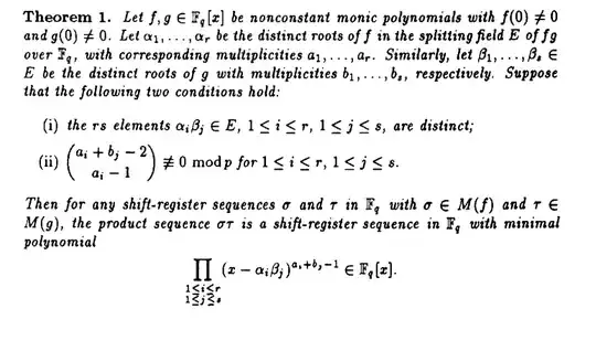

In Eurocrypt 93, Gottfert and Niederreiter (On the Linear Complexity of the Products of Shift-Register Sequences) proved the following result. The notation $\sigma \in M(f)$ means that the sequence $\sigma$ has minimal polynomial $f.$

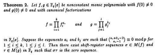

The presentation is quite technical, and sometimes such product sequences can be zero! In the other direction, the linear complexity can be as high as the product of the linear complexities, instead of the sum:
So, the linear complexity can be as high as the product of the linear complexities (take $a=b=1$ below):

1Agree, I just tried to bring out the complexity a bit. And the collapse to the all zero sequence in some cases is amazing. – kodlu Nov 17 '22 at 16:42
Agreed on the zero sequence; I'm trying to figure out minimal examples with $a=b=2$. I think it can only be for some initial fills, but I'm thinking it through. – Daniel S Nov 17 '22 at 16:55
