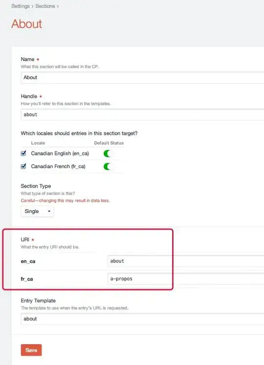

When you write:
I've had the most luck with this nginx config, together with specifying the local in the section urls in the cms for each section.
Are you referring to:
If so, and you put the locale, in this case: fr_ca/a-apropos, try removing fr_ca.
