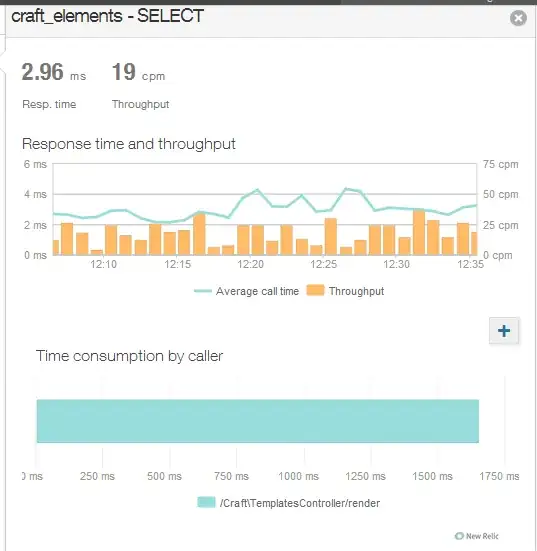

I'd like to get Craft working with New Relic so I can play with my two favorite apps. My web host (EngineHosting) got the New Relic daemons et al going; has anyone tackled getting the Craft side going so that it reports in?
Let me know, please? I may be doing some learning in order to do this integration down the line; but if someone has tackled it, I could dive right on in a bit more quickly.

    Can't say I've done more than just install the standard php monitor but it seems to work fine for me, the only downside is everything on the front end gets run through /Craft\TemplatesController/render so that kind of makes the transaction monitoring part a bit useless. – Josh Angell Jun 25 '14 at 10:20
  • Alright awesome. I'll use this to do some troubleshooting and figure out what is going on. Thanks Josh! – Lisa Jun 25 '14 at 14:39

  • This was absolutely a question about how to integrate Craft and New Relic on EngineHosting. The fact is, EngineHosting does the entire New Relic setup because it is a fully managed server (as opposed to something like cPanel or Plesk). I asked them to make it happen, and it did.
    Craft itself doesn't integrate specifically with New Relic: I mostly get information about index.php. A plugin (or core integration) would be required to get more sent from Craft to New Relic; a project that I'm unlikely to tackle myself but am considering.
    – Lisa Jul 12 '14 at 19:26
Not quite sure what happened here; Brandon over at EngineHosting re-ran the installation and now I see my info in RPM.
So for future New Relic users that want to integrate with Craft on EngineHosting - at its most basic, ask EH to get New Relic installed for you.

Editing as requested. EngineHosting fully manages my site/server. I don't have root via SSH so asked them to get the New Relic PHP agent installated (the agent installation requires root). EH did install NR for me, but the first installation did not work and I do not know why. When EngineHosting re-ran the installation, the PHP agent worked and Craft (and other PHP apps, mostly the 'index.php' file for each) started reporting to APM.
That's not helpful for people on cPanel or Plesk hosts, admittedly, nor is it helpful for people with root access doing their own installations. But if you can get the New Relic PHP agent installed where Craft is, then it will report to APM. Looking forward to getting more specific metrics from Craft to New Relic down the line, but that is not likely to come from me :)
With that very basic installation I get information like this:
Craft in NR APM
I hope that helps.
