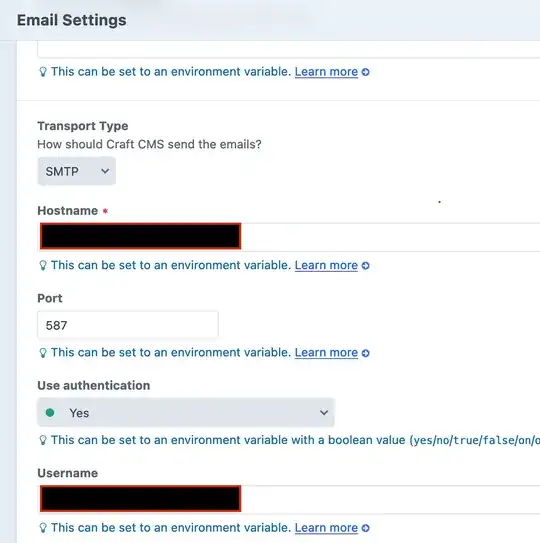

I want to use the settings I have set in the CP:
I would be very thankful for an example, as the Craft 4 documentation is a bit to sparse for somebody like me .
