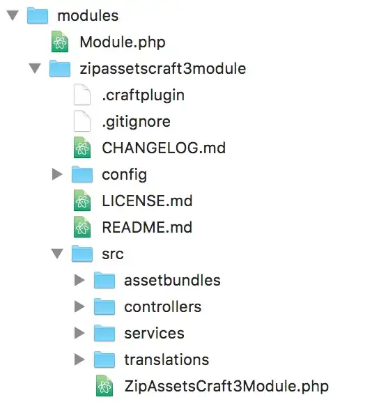

This is the file structure of the module: enter image description here
So the error message says, there is a class missing, in which file is this class looked for?

  • I found the right paths in the readme.md file. – obs Jul 03 '19 at 11:50
