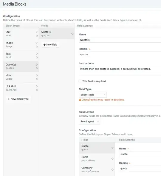

Here's a snapshot of what the field looks like in CP:
quotes super table field in mediaBlock matrix field

  • Could you maybe explain the first code snipped? I don't really see why this is important or what it should be good for. You could use this as reference. It's without a super table field but they work similar https://craftcms.stackexchange.com/questions/21864/how-to-save-matrix-data-programmatically-in-craft-3 – Robin Schambach May 23 '18 at 20:09
  • Sure, it is pretty confusing. I'm trying to find the $blockType for the Super Table field that's inside a Matrix field. It's much easier to just find this info for a base Super Table field (that's not inside a matrix field). I'm guessing there's a simpler way to find that $blockType, but the code block at top was the only way I was successful. – Nate Beaty May 23 '18 at 20:57
  • Are you going to change/delete your fields because that's what calling by handle is good for. You can as well grab the field by id directly. It's not as dynamic as your approach but yours won't work anymore when you change the layout as well – Robin Schambach May 23 '18 at 21:20
  • There aren't any plans to change fields, and I did initially just use the field ID by checking the database directly. I sent this issue to the Super Table devs also in case they wanted to chime in — I was just wondering if there was a more elegant way to find a Super Table's field info from inside a matrix field. – Nate Beaty May 24 '18 at 20:39
