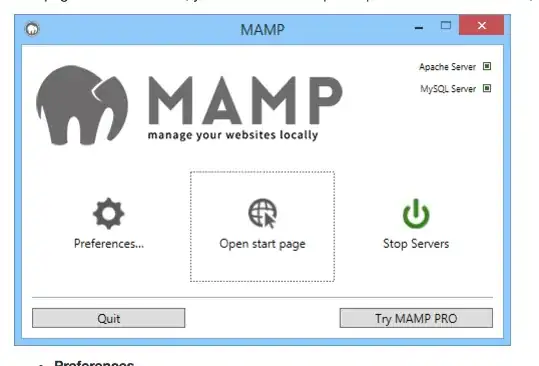

Also check in your MAMP control panel that the MySQL is actually running:
