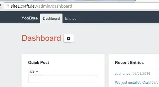

Here is a screen shot of the domain I have it installed at:-
Domain

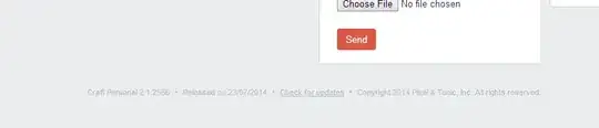

Here is a screen shot of the footer:-
Footer
How would I activate the trial licence (I am probably missing something obvious, so forgive me if this is the case) :)?

I know it sounds silly, but try refreshing or clicking another tab (like entries). What you should see is in the attached screenshot. enter image description here
Click that box and click "Try" and you should be all set.
Peter Tell
  • 1,828
  • Thanks Peter, gave that a go, but unfortunately it did not help :( – Karnage Aug 12 '14 at 13:35
  • Try the settings page, @Karnage! – carlcs Aug 12 '14 at 13:36
  • If carlcs's suggestion doesn't work, could it be that your blocking the outbound request? What happens when you click "Check for Updates?" – Peter Tell Aug 12 '14 at 13:39
  • Ok, can't see it on the options page - But, I think you may be onto something with the outbound requests being blocked as when I click on "Check for Updates" I get an error. I am using WAMP - not sure what could be blocking it though? – Karnage Aug 12 '14 at 13:48
  • What's the exact error message you are getting? Is it possible you are trying to do this from a non admin account? – Peter Tell Aug 12 '14 at 14:26
  • Thanks for your help guys. I got it working by moving to Bitnami WAMP stack (instead of WAMP Server). – Karnage Aug 12 '14 at 15:32
  • Glad to hear it! – Peter Tell Aug 12 '14 at 15:33
  • FFR, you could check the craft/storage/runtime/logs files and see what the underlying error is. Most likely something to do with cURL from the sound of it. – Brad Bell Aug 12 '14 at 17:44
I found this in the release notes of Craft 2.0.2535:
The upgrade promo is now only shown on the Settings page if you’re running Craft Client.
Maybe this is also true if you are running Craft Personal? I'd look for the link at the bottom of the settings page...
