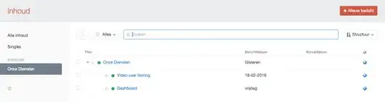

I wondered if it is possible to use one specific template for just one structure.
My structure build up
So let me make this clear. I have a structure called "Onze Diensten" (Our Services) and inside are child structures that are the actual services that the website offers. These child structures use a template that I assigned to them through structure so that works perfectly. But what I want now is that the actual "Onze Diensten" gets it's own individual template which would show all the services on one page.
How do I do that? Thank you for taking the time reading my question.
What I hoped would be the solution is using routes. By adding a route that when you visit onze-diensten/ it would load up the template onze-diensten/onze-diensten/ (Which is the path to the template I want to use).
But it seems to completely ignore the route at all.

I can't answer it clearly, but I did a workaround for something similar.
I've loaded the same template for my structure but gave my structure 2 entry-types(overviewPage, detailPage).
Both entry types loaded the same template but got handled differently. So my template for the structure looked something like this:

  • Thanks for your input! This explanation I can understand I also saw another thread on the same issue I believe and apparently someone gave a very good solution. But I don't understand what he did probably because I am still new at Craft. But maybe it can help you so here is [the link.] (http://craftcms.stackexchange.com/questions/96/how-can-i-route-a-specific-entry-in-a-structure-section-to-its-own-template) – Jeffrey Stevens Mar 02 '16 at 08:46
  • But how do you give different handles to the same structure? My structure handle is onzeDiensten and all the child structures get the same handle. Which means that I can use {% if entry.type == 'onzeDiensten' %} but I can't make use of the elseif beneath it because all the structures have the handle of onzeDiensten. – Jeffrey Stevens Mar 02 '16 at 09:13
  • Make sure to define a second entry.type in your structure. And add this new entry.type you your entries. You can than handle those entries depending on their entry.type. – Marco Schuler Mar 02 '16 at 09:23
    Marco, you are a genius. It works. I tried it failed a couple of times but eventually it worked out great! So thank you so much now I can finally move on with my project. – Jeffrey Stevens Mar 02 '16 at 11:07

I just noticed something.
"Onze Diensten" is your structure. In this structure you made an entry "Onze Diensten" on the first structure level.
If this "Onze Diensten" entry only is an overview of all it's children entries and doesn't contain any extra content you could just remove the "Onze Diensten" entry and make all the children entries on the first structure level.

    I need "Onze Diensten" To be an entry on it's own for the navigation plugin that I use. Otherwise I can't make a submenu with children in it. – Jeffrey Stevens Mar 02 '16 at 10:07
