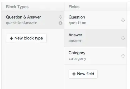

I'm setting up an FAQ page using a matrix. Each Matrix block contains a question and an answer field. Each Q+A needs to be outputted within a section on the same page such as General, Payments...
I've figured the best way to do this is using categories to assign the Q+As section, limiting each Q+A to one category. I'd then need to output all Q+As for each section with it's category as a header.

I'm fairly new to craft so perhaps I'm overcomplicating it by assigning it to a category, it seems like it's the easiest way to add new Q+As and for them to appear within the right section.
How would I go about outputting this? I've set up a Category Group called 'faqCategories'
Here's my matrix setup:

It's tempting to use the Matrix block for things that might actually be better as a a channel or a structure. I thing this might be the case here.
The way you've set it up is fine, relating each FAQ to a category is a good approach.
In any event, the plugin groupBy should help you:
https://github.com/timkelty/groupby-craft
Or you can look at this example:
http://craftcookbook.net/recipes/279
andrew.welch
  • 11,551
  • Thanks. After your comment I'm now using a structure instead where each section (General, Payment..) is now an entry rather than a category, and then I have the matrix inside each entry to add as many Q+A as required. All gets outputted in my singles FAQ page. – sarah3585 Nov 22 '15 at 16:47
