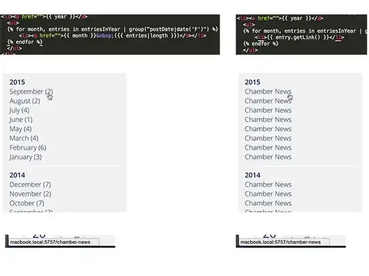

With a bit of looking around i've got the following code on my News landing page:
  {% set allEntries = craft.entries.section('chambersNews').limit(null) %}
  <ul id="archive">
  {% for year, entriesInYear in allEntries | group("postDate.year") %}
      <li><a href="">{{ year }}</a>
        <ul>
        {% for month, entries in entriesInYear | group("postDate|date('F')") %}
            <li><a href="">{{ month }}&nbsp;({{ entries|length }})</a></li>
        {% endfor %}
        </ul>
      </li>
  {% endfor %}
  </ul>
Using <li><a href="">{{ month }}&nbsp;({{ entries|length }})</a></li> I get the desired result (visually), see attached image. If I use <li>{{ entry.getLink() }}</li> I get the result shown on the right of the attached image.
In both instances I only get a link to the first segment (also shown in the attached image).
What I would like to do is have the Months link to a page that lists just the articles from that month (I don't need the year to link).
I assume I need to add a dynamic link into the href but how and what?
Many thanks in advance.
Martin
Need the left hand side linking through to a page showing articles from a chosen month

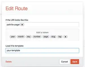

Now here's the bit that caused the grief... Instead of having 'month'-'year' as part of the route, P&T suggested using just '*'.
Route using asterisk
Or.. as P&T put it:
Your dynamic route is set with the Month and Year token. If you look at the list of available tokens, you will see that Month and Year follow a specific format, which the URLs you set up in your menu do not follow. Therefore, those URLs do not follow the pattern you set in the Route and you get a 404 page.

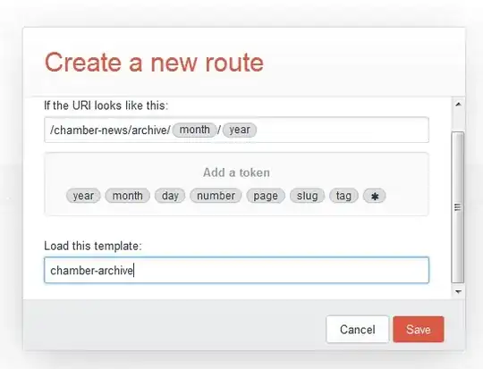

The code on the left is what you want to use... Here are the general steps to follow to put everything together.
Since you're creating an archive page, you have to explicitly tell Craft what to do. First step then is to set the URL to something like:
href="/chamber-news/archive/{{ month }}/{{ year }}"
Then set up a template (my example uses one named "chamber-archive") which looks to the URL for the month & year to determine which entries to load. (altered code borrowed from this answer)
{% set month = craft.request.segment(3) %}
{% set year = craft.request.segment(4) %}
{% set firstDay = now | date_modify('first day of ' ~ month ~ ' ' ~ year ~ ' 00:00:00') %}
{% set lastDay = now | date_modify('last day of ' ~ month ~ ' ' ~ year ~ ' 23:59:59') %}
{% set archive  = craft.entries.section('sectionNameHere').postDate('and', '>= ' ~ firstDay, '<= ' ~ lastDay) %}
Then you need to set up routing to tell Craft to use this template for this URL pattern.
