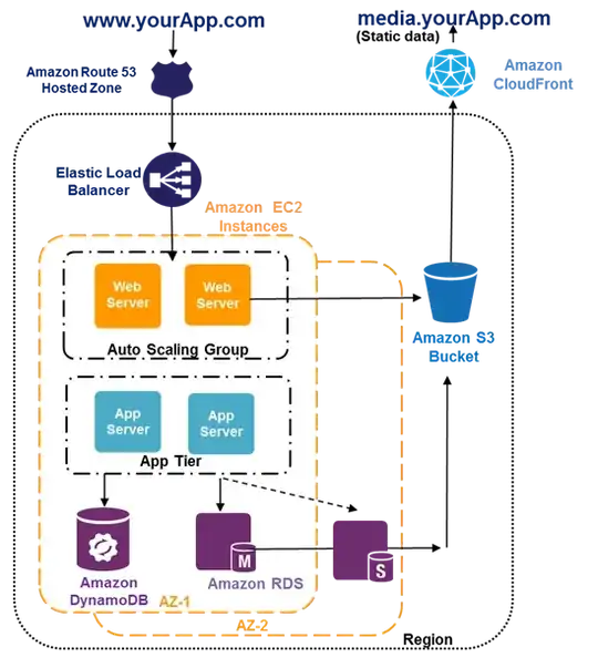

One thing we do (at Airtype Studio, where I work) for larger installations is set up a couple of load-balanced pools of servers: an app tier and a web tier. In fact, the environment architecture is very similar to this:
aws architecture
This type of architecture is commonly referred to as an n-tier architecture. You can read more about it here: https://stackoverflow.com/a/312197/3053214. Basically, web servers can't talk to the database; Only the app servers can. This allows you to lock down who or how the app servers are accessed. It also provide a layer of separation between software that can be publicly attacked (the web tier) and the database, which inherently has advantages outside of the context of this question. Anyways, moving on.
So where does Craft fit into this big picture and more importantly, what does this have to do with migrating data across environments? I'm getting there, just bear with me.
We install Craft on the app tier and basically build an API (either by outputting json via twig which can get hairy, or building plugin to map routes and output json for us). On the web tier we have a php app (like Laravel, Yii, Slim, etc - we typically choose Laravel) that makes requests to and consumes the app tier API that Craft is controlling.
From a git standpoint, the web and app tiers have their own repos. They are considered two separate applications, each on their on track, although they work together as one. Each application has their own dev and staging environments. This allows us to point our web-dev environment to our app-production environment. I could have a whole convo on what a git workflow looks like in this situation, so if you're interested, hit me up.
To manage content across multiple environments, we don't actually migrate data at all. We elevate it. What I mean by this is all web tier apps typically point to the production environment of the app tier. It's no different than pulling data from a 3rd party source, like Twitter for example. You don't point your dev environment to Twitter's dev environment do you? No, you'd have your dev code point to Twitter's production environment. My main point is, don't feel like your web-dev environment has a 1 to 1 relationship with your app-dev environment. Just don't think about it like that.
On entries within Craft, we use a multi-select or checkbox custom field that contains a list of our environments. By checking which environments the content is allowed to be viewed in and querying Craft with the environment criteria, we can effectively limit where our content is allowed to show up.
So really, a request for us goes something like this:
  1. The user requests http://website.com/about
  2. The web tier makes a GET request to the APP tier to get the about page info. The environment of the web tier is sent over with the GET request (either as a custom header or a query string parameter).
  3. On the app tier, Craft reads the criteria pass from the web tier and gets the content that matches the criteria (entry, environment, etc).
  4. The app tier returns a json response to the web tier.
  5. The web tier handles presenting the view, or template (which is a non-Craft template).
Now I realize that many of you have no need for a load balanced, multi-tier environment. Not to mention that setting all this up as described above is a lot of work and in many situations is super overkill. However, you can apply some of the principles of what I'm describing to an environment that as a much smaller scale. For example, you could set up separate virutalhosts on the same server and build out web and app environments there.
A couple of thoughts about all of this:
  1. Having a standardized, RESTful Craft API would make something like this a lot easier. As described above, creating that app tier API is up to the individuals creating the site. This can lead to inconsistencies in the API if not done with care.
  2. Having environment support natively on elements would be ideal, rather than a custom field.
  3. The method described above opens up a ton of avenues for Craft. Since your Craft has an API now, the tech that drives the "web tier" can change. It could be .NET app, Android app, or iPhone app. Just think long and hard about exposing the Craft API via javascript. You should probably have your javascript hit an endpoint on your web tier that queries the app tier if you are really going for security.
