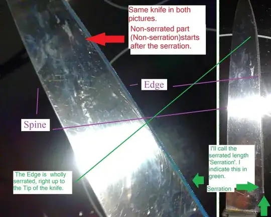

But wouldn't sharpening efface and remove the serration? Or can the professional recreate the serration? Here's my knife that needs sharpening, where I use these knife terms:

  • Could you just remove all the labels in the image, and drop the extra knife parts image? The only additional information the images are really conveying is the type of serration, and the red label is still misleading. – Cascabel Aug 10 '18 at 20:46
  • You have the wrong terms that is not a serrated knife. – Jade So Aug 10 '18 at 21:19
  • @Cascabel Can you please reject the edit? Then you or I can remove the 'knife parts' image. That is clearly making this confusing for users who may want to answer. – Cindy Aug 11 '18 at 15:19
  • @Cindy have at it! – Cascabel Aug 11 '18 at 16:05
  • @Greek-Area51Proposal As Cascabel suggested, please remove the tags from your photo. They are confusing. (Especially the one in red font.) Anyone capable of answering your question wouldn't need the type of clarification you are trying to provide. – Cindy Aug 11 '18 at 19:36
  • @Cindy Sorry. I don't have the original picture anymore. –  Aug 12 '18 at 02:56
  • @Cascabel Sorry. I don't have the original picture anymore. –  Aug 12 '18 at 02:56

  • Sorry; I'm new to this and don't understand. (1). "They can't really." So is this dull knife useless now? Ought I bother taking it to a professional? (2) "You could probably very carefully sharpen the flat section of the knife in the picture" To where are you referring exactly? Do you mind illustrating this, e.g. with Paint on my screenshot? (3) "the serration at the base" Same as 2. –  Jul 26 '18 at 03:53
  • Can you please respond in (by editing) your answer? A chain of comments is more cumbersome to read. –  Jul 26 '18 at 03:54
    @Greek-Area51Proposal I believe I misunderstood the text on your image. is the entire length of the blade serrated? I took the red arrow to mean part of the blade had a smooth flat edge. – Summer Jul 26 '18 at 03:56
  • "is the entire length of the blade serrated?" No. The red arrow refers to the (main) part of the blade, which is truly smooth, flat. –  Jul 26 '18 at 19:06
    @Greek-Area51Proposal I'm not sure you're talking about the same thing still. bruglesco is asking about the full length of the edge of the blade, the theoretically sharp part you might cut with - is that serrated essentially all the way from tip to handle? Or is it unserrated toward the tip where your red arrow is, and serrated back toward the handle where the green arrow is? (All knives of course have a smooth body of the blade above the edge; that's not the part of the knife that cuts things, and serration modifies the cutting edge, not the body.) – Cascabel Jul 27 '18 at 21:08
  • @Cascabel Sorry. I'm doltish about knives. The Edge is serrated all the way to the Tip. –  Aug 10 '18 at 20:36

The way I do it is to sharpen the knife like you would normally with a flat edge, and hit the area you want serrations with a 36 grit belt grinder. The last step would be to remove the burrs with a fine scotchbrite belt on the grinder.
If you want to do this by hand without any power tools, use a triangular needle file to sharpen each individual tooth.
