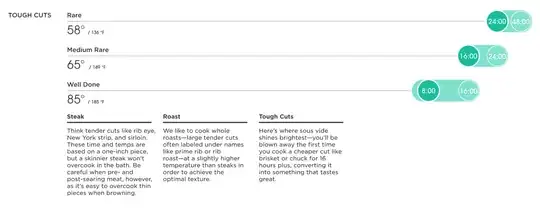

According to ChefSteps, tough cuts, like brisket, is where sous vide really shines. If a company that specializes in sous vide is advocating for the use of it on brisket, I would trust that it is perfectly fine.
You can check out there website for recipes and additional information: ChefSteps
ChefSteps Sous Vide Guide
