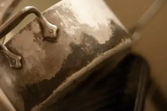

I can answer you with first hand experience and a picture. Your lovely dark gray finish will become light gray, streaked, and hideous. I'll never buy this style of pot again, it is just too useful to be able to dishwash them sometimes.

1Ouch. I don't even want to imagine what it must have been like opening up the dishwasher door and seeing that. – Aaronut Oct 21 '10 at 14:02
Damn. I would hardly believe that's an All-Clad pot if not for the stamped handle. – hobodave Oct 21 '10 at 17:35
3Yeah; to be clear that is probably 5 times through the dishwasher. Once it was ugly the first time, I sorta figured, what the heck. – Michael Natkin Oct 22 '10 at 03:38
Wow. I've washed it a couple of times and so far it doesn't look that bad...but I'm not going to do it anymore! Yikes. – milesmeow Oct 25 '10 at 03:53
Dishwashing fluid isn't a simple soap; it's much more aggressive. A good portion of it is sodium hydroxide (lye) and sodium carbonate (washing soda) which will dissolve the protective anodized layer on aluminum surfaces (aluminum oxide), which is what holds the color.
Anodizing is a process that grows a layer of aluminum oxide on aluminum surfaces that can be dyed to form an attractive finish. The dissolution of the anodization is why Mike's pots look so bad now.
Sodium hydroxide and other bases can attack aluminum (metal), but it's not as apparent, especially when the concentration is fairly low. Remove a very thin layer of silver-colored aluminum and there's more silver-colored aluminum under it. Remove some of the anodization layer, and the dye can come out.
