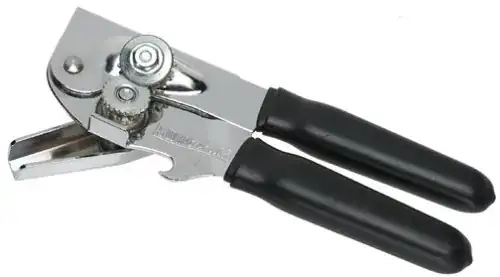

Is there any way to fix or adjust a hand held can opener? I keep buying new ones because
within a month or so of buying them, they won't roll correctly on the can lip.

4There are many different type of can openers. Please attach a picture of what you have – TFD Mar 11 '15 at 07:02

It's really easy to cure generally. The main cause, be they cheap or otherwise, is the non forced roller cog (not the one attached to the twister, but the one that sits below the circular blade) siezes up with rust. A vigorous blast with an old toothbrush, then undo the Phillips screw and remove. Carefully pull the blade and cog off - remember it's meant to rotate so if it's still stiff use a small pair of pliers and rotate it until it's lose and free. Pull the blade and cog off the spindle as mentioned and clean all parts quickly with the brush. If you have some WD 40 spray a bit onto a paper towel and then wipe the spindle with the towel. Reassemble. Should work a treat. I've literally just done this to a siezed can opener and it works like new. Took 3 minutes flat!

3$10 or so has always been enough for me. Get something with solid metal, not one of those punched out things held together by rivet. The rivet'll stretch and make it hard to get the cutter angle right and stable. Fit is important, and a cheap piece of trash won't hold a good fit for more than a few months use. It's possible to sharpen the cutter blade w a diamond file. Some types have replaceable cutting blades. – Wayfaring Stranger Apr 26 '15 at 12:13
