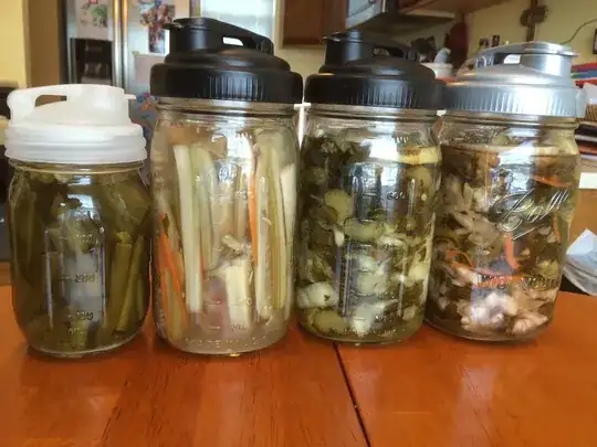

I bought this FARMcurious Fermentation kit on Kickstarter. Once I got it and started making it I found their claims of it being "super easy" were a little exaggerated. When looking around online I found that other people recommended weighing your salt instead of measuring by volume and that it absolutely did matter what kind of salt you used (so I rinsed the veggies off and started over).
I started them fermenting in August and was supposed to check them in October. Well, it's now January and I've just been too afraid to try them.
There is no mold growing, they've been in a dark room in my basement. The airlocks are all intact. Nothing "looks gross". I opened up one that had cucumbers, carrots, and celery in it and it just smelled vaguely "pickly" (not bad at all). I tasted one and it was just sort of soft-ish and very salty. It's been 2 hours and I'm not dead or sick or anything.
My question is... What are the dangers here? How would I "know" if it "didn't work" or if it "went bad"? This person tested PH and looked at it under a microscope. What would I look for exactly (I happen to have the exact same microscope)? What would happen if they were bad and how long would it take to happen (if I ate some)?
Most stuff I've seen online claims that if it were dangerous it would smell so bad you couldn't even eat it and that this is the absolute most safest method of preservation.

  • Got some PH test strips and tested them. They are around a 3. I tried the one with all the celery in it (third from the left) and it tasted... krauty. Kinda good, but milder than kraut normally is. The green beans had a very small amount of white stuff (mold?) floating on top, haven't tried yet. It's PH was the same as the others, so, not sure how it got the white stuff... – cmcculloh Jan 10 '15 at 17:53
  • Mold can't grow in the brine. It can grow on top, where there's oxygen. This is why the food must stay submerged. And why you simply skim the mold off and discard it, with the rest being fine. – gbarry Jan 16 '15 at 21:12
    Been eating for 10 days now and am fine. – cmcculloh Jan 20 '15 at 20:34
