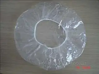

I don't know why gas ranges sometimes cause that problem, but you're not the first I've heard say it. What I can offer is a solution. Buy a shower cap, one of the cheap types that are sometimes offered in hotel rooms.
Slip one of those on the closest smoke detector. Since your detectors are interconnected, removing the battery every time you cook is probably a PIA, if even possible, the shower cap only takes a second. I do that when I sear steaks. I used to remove the batteries, but the shower cap is quicker, easier, and works just as well.
