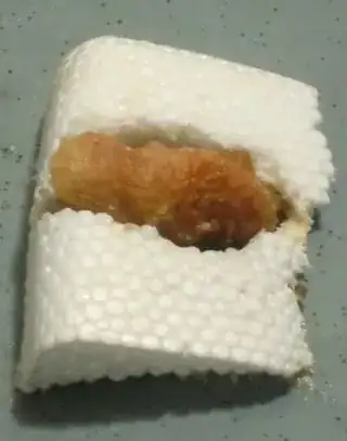

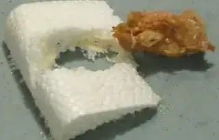

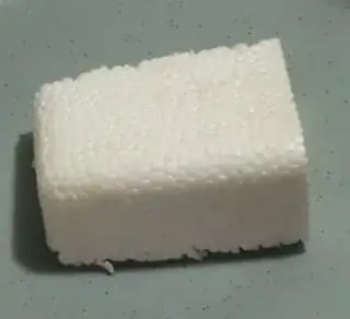

Well, I can tell you with absolute authority that polystyrene melts in the microwave.
Here's a chunk of polystyrene cut from a foam shipping container. I double checked with the website (Propak), and the stuff is polystyrene.
I placed a random chunk of chicken on the cube, and microwaved on high for 1 minute.
2 3
So yeah, it melts. Is it toxic if it melts into your food a few times? Probably not. Should you do it? Probably not.

    @alexwlchan Pfft...easiest experiment I've done to date. My kitchen still stinks though :) – Jolenealaska Oct 14 '14 at 13:00
    Worth noting: the food in the polystyrene trays will absorb the vast majority of the microwave energy, not the tray. Melting of polystyrene trays is rare, unless you're trying to catch the meat on fire. This experiment was carried out with just the polystyrene in the microwave. – Robert Harvey Oct 14 '14 at 15:27
    @RobertHarvey "This experiment was carried out with just the polystyrene in the microwave." This is clearly incorrect if you read the answer, or look at the pictures ("I placed a random chunk of chicken on the cube, and microwaved on high for 1 minute."). Actually, I'm not sure where you came up with this. – Digital Chris Oct 14 '14 at 15:42
    @DigitalChris: Eww. Fair enough. But do you really think that random chunk of chicken you're heating to glowing is the same scenario as a piece of meat you're thawing to room temperature? – Robert Harvey Oct 14 '14 at 15:47
    @RobertHarvey I see nothing in the question that limits its use to thawing to room temperature. What if I'm reheating my lunch and don't realize how powerful the office microwave is? – Digital Chris Oct 14 '14 at 15:56
    From the picture, it seems you are heating up a very small amount of food for an excessively long time. One minute on high is usually what is suggested to heat up an entire food tray from room temperature to piping hot, a tiny chunk of chicken receiving the full brunt of that would be burning up. It's no wonder that the polystyrene melts. I don't know what point you're trying to make here, but this is clearly not a normal operating temperature for reheating food. – Lie Ryan Oct 14 '14 at 16:01
  • @DigitalChris: See Lie Ryan's comment, just above this one ---^^^ – Robert Harvey Oct 14 '14 at 16:22
    Even if it's abnormal, that doesn't mean it isn't possible. The point is: under some conditions, it can melt, and that's not great. It might not melt in all applications in all microwaves. If you want to test in further detail then go right ahead. – logophobe Oct 14 '14 at 18:41
  • @LieRyan Of course microwaving a random little chunk of chicken on a cube of packing foam isn't "normal". Do you have a point? – Jolenealaska Oct 15 '14 at 06:25
    Point? You aren't answering the question. There are different types of polystyrene with widely differing properties. This question is about food grade foam, you're taking packing foams. Any plastic containers can be damaged in microwave given the right conditions, you're heating an object much more than any reasonable person would do. Conclusion: using microwave improperly may not be a good idea, but I still don't know whether or not I should be genuinely worried about melting polystyrene. – Lie Ryan Oct 15 '14 at 11:59
  • @LieRyan I apologize for sounding snippy, that was not my intention. My point is simply that polystyrene can melt in the microwave. That's it. I intentionally set out to use stuff that would photograph nastily because it says meh, all things considered, I'll use a plate. – Jolenealaska Oct 16 '14 at 06:07
