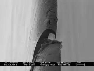

Very blunt knives need to be reworked by stone or sandpaper
The edge on a very blunt blade will have folded over itself and lost a lot of its proper crystal structure. It's also likely to have lost a lot of its bevel geometry too, so the edge won't be "straight" longitudinally.
Your best bet would be to invest, just one time, in sending it in for professional sharpening, then keeping it sharp using leather stropping or a honing rod.
Don't try to sandpaper it as there is no way to ensure proper bevel geometry with sandpaper without some professional equipment.
And...sending the knife in will be cheaper than buying a set of wetstones (which most folks don't know how to use properly anyway).
Here are some images of folded and blunt edges: enter image description here enter image description here

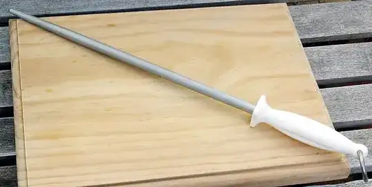

Do you mean by "sharpening steel" a honing steel?
enter image description here source: Wikipedia Commons; by Donovan Govan.
A honing steel is not intended to sharpen a dull knife but only to straigten a skewed blade [1]. (Exception: a diamond honing "steel" but I think it it still not intended to be the only tool to sharpen a completely blunt knife, [2])
If you want so sharpen you knife in a cheap way: Use sandpaper instead of a sharpening stone. :D
