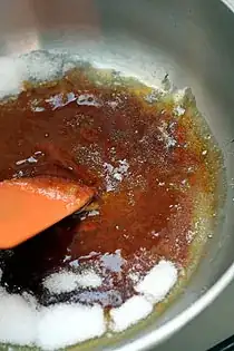

First, I just made a dry caramel as per David Lebovitz using 1/2 cup (100g) of plain granulated sugar. I took his advice and brought the caramel to a darker point (closer to burnt) than I might have otherwise.
3 4 (Mr. Lebovitz' photos, not mine)

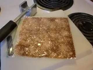

So I broke it up and put it into a heavy Ziploc. Then I alarmed my neighbor (he called in panic) by beating the crap out of it with the smooth side of a meat mallet.

At this point I didn't have great hopes, but I figured I'd see if I could make anything useful out of this. I called my neighbor to warn him, then I proceeded again to beat the crap out of it.
At this point I tasted it and kind of liked it, but the sizes of the pieces were all over the map. I didn't like that. I also didn't like the way it looked; the dust marred the glassy appearance of the larger shards.
So I grabbed three sieves of varying fineness and proceeded to work the candy through the holes. Anything that went through the fine sieve I called "fairy dust". By spending some time working out the "dust" I was left with larger, cleaner shards. I worked those through a pasta colander, then a big pasta colander.
