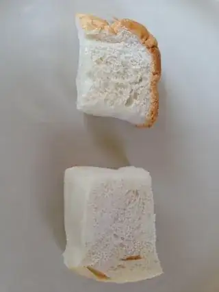

I would like to make the dense&soft bread like the bottom one and the taste is plain not sweet. What techniques will make bread closer to the one I want? I also want it to be chewy, not just soft.
Comparison between normal bread and the dense bread

It is hard to say without seeing the whole loaf, but the crust and crumb of that bread look like a pullman loaf.
A pullman loaf
Pullman bread (usually called pan de mie in Europe) involves baking the bread in a pan with a tight fitting lid. As the bread proofs, it comes in contact with the lid. This restriction causes the bread to retain a very fine crumb since it can't expand too much. This fine crumb, and the soft crust caused by being completely surrounded by a pan, make pullman loaves ideal for sandwiches.
Sometimes mass-produced proof-and-bake breads for grocery chains will have a similar texture, but it is usually a combination of making the bread with shortening and a bit of sugar for tenderness, and a lot of dough relaxers and oxidizers to control the texture.

It is hard to achieve what you want. Starch makes bread soft, gluten makes it chewy. Normally, you would want flour low in protein for soft bread and flour high in protein for chewy bread. The protein in the bread combines to form gluten during kneading, which is chewy. The chewy bread is also less dense, as the rising process is a bit like filling tiny baloons with gas, and the gluten "baloon walls" stretch better and make larger holes.
What you can do is to opt for AP flour, which has a medium protein content. It will be softer than bread made with bread flour. You have to use a finely milled flour, whole wheats won't work at all (they will make the bread dense but not soft). I am a bit puzzled as to what amount of kneading to suggest. For bread like on your picture, I would say that you should underknead a bit, to make it soft. But the more you knead, the chewyer your bread gets.
To make the bread softer, I would use milk instead of water. Breads made with (full fat) milk normally look like the one in your picture.
Adding an egg yolk (or pure lecithine, if you have it) will make it a bit softer too, and give it a smooth quality. Don't add whole eggs, as the egg white makes it more dry/tender, less supple/soft. A little bit of fat is also a filler which makes for softer, denser bread. These are not as important as the milk though. You will have to try around a bit and see what you prefer.
The optimal hydration is probably 60%. I have seen (and made) bread of roughly your style with 60% and AP flour. More will give you larger holes; less will make the bread denser, but also less soft.
To make it dense, you want a short rise. Skip the punching altogether; rise once, then shape, proof in the pan, and bake. Don't use a pizza stone or a preheated pan, these will give you large holes.

  • @rumtscho Thank you so much rumtscho. The hydration is the %of water (or milk) compared to the rest of the recipe, am I understand correctly? and when you say skip the punching altogether you mean that you suggest not to knead? just mix and let it rise 1 time? you are really cool ^^ – user23839 Mar 17 '14 at 14:08
  • does the straight dough process or sponge dough process make differences which one is suitable for my project? – user23839 Mar 17 '14 at 14:27
  • Hydration is usually measured against bakers percentage, where the flour is 100% by weight, and each other ingredient is in a ratio to that, so a recipe with 1000g flour and 600g water would have 60& hydration. I understand that some European traditions use the water as the 100% ingredient. – SAJ14SAJ Mar 17 '14 at 16:17
  • @user23839 a short sponge shouldn't have much effect either way; don't do any long (overnight) fermenting. You should knead the dough. I'd knead until I see the first signs of sheet building (window pane), but without waiting for the dough to start pulling itself together, maybe about 10 minutes of hand kneading (or slow mixer speed). Then let it rise once until doubled. Now, instead of rekneading and a second rise, shape directly, let it rise in the pan, and bake. – rumtscho Mar 17 '14 at 16:18
  • thank you so much t-t you are really nice. I love this community ^^ – user23839 Mar 17 '14 at 16:33
  • My dough doesn't get window pane after I knead for 10 mins and I continue until 60 mins, it still don't get window pane. Why? My recipe is AP flour 370g, Milk 225 g, sugar 10 g, salt 6 g, 1 egg yolk, Yeast 7 g, butter 40 g. I start mix half of milk with sugar, salt, butter and the other half milk with yeast and flour( start with 1 cup and keep the rest) then I mix 2 parts and egg yolk together and mixing and adding the rest of the flour cup by cup then I feel it too sticky then I add a bit more flour to it. and I knead very hard for 10 min. Room temperature is 34 C. It doesn't get window pane. – user23839 Mar 19 '14 at 06:09
  • Mr. Rumtscho may I have your email please? I will send photo of the bread to you – user23839 Mar 19 '14 at 08:40
  • the texture of the bread are very loosely. I'm not sure it is because I knead it too hard or too long or I add too much flour during the kneading process or there are something wrong with the recipe or if I bake too long in the oven? (I use 180-190 C for 50 mins) or because there are no water in the recipe? t-t – user23839 Mar 19 '14 at 08:55
  • Can you suggest me how long I have to leave it proof in the pan before bake it? – user23839 Mar 25 '14 at 15:55

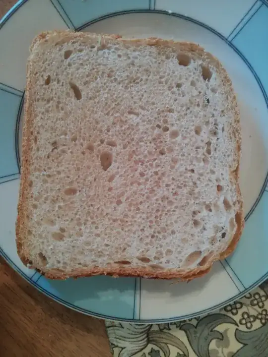

Reducing the amount of yeast, in my experience, will make a denser bread. Below is a photo of a French style white loaf made with 50% the amount of yeast I would normally use. The bubbles are noticeably smaller, and the texture is different.
Does reducing the amount of yeast give the desired effect, or get any closer to it, for you?
