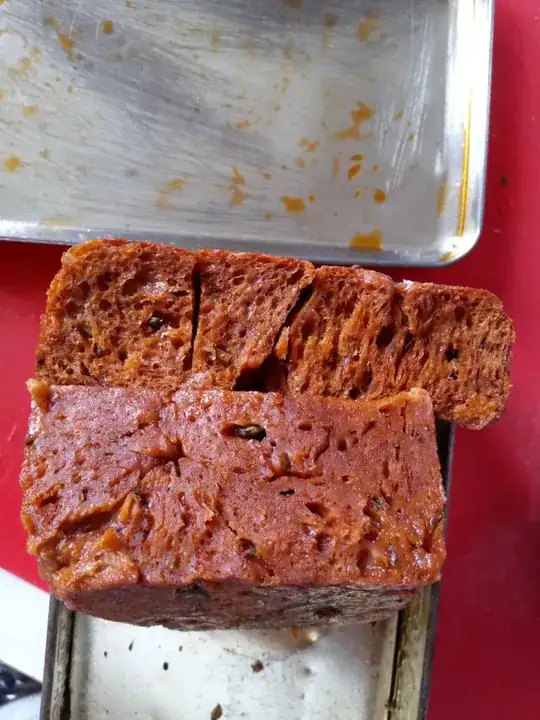

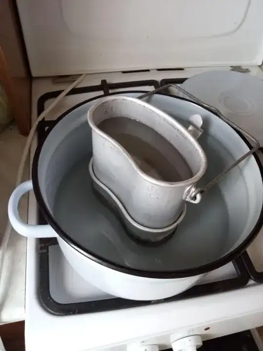

I managed to make seitan with a texture of thoroughly tenderized meat. The secret is pressure:
I just tightly packed the dough in a pot, and pressed down the dough using another pot with water. Then I cooked it in a bain-marie for 90 minutes.
At the top - spongy seitan, baked unpressurized. At the bottom - meaty seitan, made in a pressurized bain-marie
The pots I used to make seitan
Bain-marie Bain-marie
