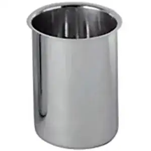

First, use the highest-sided, smallest diameter container available. The food you're puréeing should have several inches from the top of the container. If the diameter is small enough, your blender will be able to get all the food moving at once -- you'll get a nice vortex right in the middle, and won't have to do any horizontal movement, just vertical. (Essentially the same thing as would happen in a counter-top blender's jar.)
The absolute best container is what's known as a "bain marie", a cylindrical metal pan that's much taller than it is wide:
You can get these fairly cheaply at restaurant supply stores. It's not absolutely essential, though, and if you don't want to buy one, use your pasta pot or stock pot.

    The only thing I would add to this very comprehensive answer is I find holding the blender at an angle on the bottom of the pot against a side and just holding there creates a current that pulls the soup around the pot and through the blender. if the top isn't getting pulled down it's usually less messy to stop and stir it than bring the blender up towards the surface.
    Also when I've got 50 bowls of leek and potato soup to blend, doing it in the soup pot is just so much easier I'd make way more mess getting it into another container in batches anyway.
    – vwiggins Dec 20 '12 at 09:31
  • Well, ideally you'd get a bain that was big enough for your typical batch. – jscs Dec 20 '12 at 17:44
  • When I am trying to blend a small amount of food (which is often problematic in large diameter pots), I use a coffee mug that is just large enough to fit the head of the blender. – ESultanik Apr 21 '15 at 14:26
