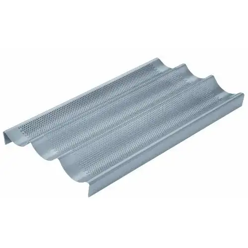

Stoneware by definition in non-porous, traditional earthenware is somewhat porous. Most modern earthenware (from Asia) though is effectively non-porous. Either way, the ability for stoneware to be "porous" to steam in any quantity will be very limited in the short trip in the oven. If you want surface stream escape use a perforated metal pan such as baguette makers use
baguette pan
Note: baguette makers use these sort of pans so stream can get to the bread, not escape from it. They use steam ovens to promote "oven spring", which is the process of using steam to keep the bread crust from hardening while the bread still rises internally in a hot oven. A lidded pan, cast iron or other material, generally simulates this effect
