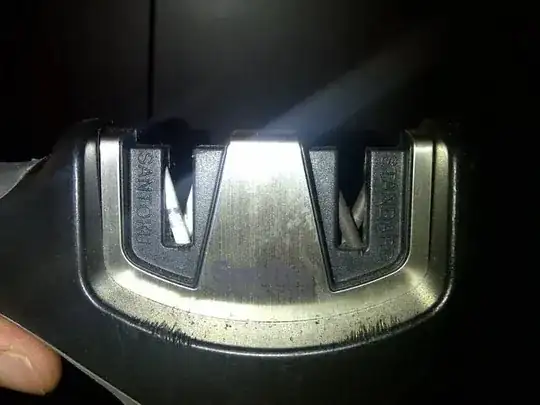

The other factor is the angle of the edge - the German/European angle is flatter than the Japanese knives. This means the German knives take 'abuse' better on the edge and requires less sharpening because of that. You can see below that there are two different angles:
sharpener
As far as which requires sharpening less, I'd say it depends on how general purpose your knife is going to be. If its going to be going through bone and all sorts of things, the German edge will probably stay a bit better and the softer steel will re-hone better. If you're mainly cutting veggies, breads, cheeses, and other soft items - the Japanese knife will last longer because the difference of edge doesn't matter as much as the steel here.
