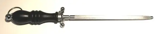

They are either made of surface hardened steel, which can't be realistically sharpened, or bonded with tungsten or diamond grit, again which can't be realistically replaced
Most steels just need a good clean; soak the steel in warm soapy water for a while, and then give it an aggressive scrub with a nylon bristle brush. Dry thoroughly
If it still does not hone well, then maybe it's time to buy a new one?

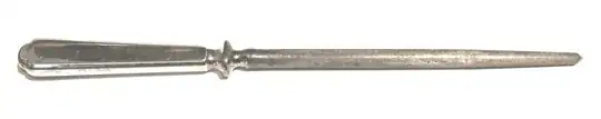

I am using a full size silver handled surface hardened steel that is 70+ years old and still works fine. It looks quite beaten up, has had surface rust, but always brings a knife back to life
Good steel
