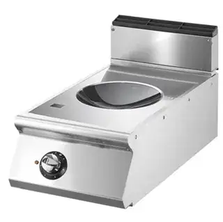

I wonder if an induction hob shaped to match a wok, like this one, might actually have as much heating power as a gas burner:
My questions:
  1. How much actual power (in Watts) is delivered by a wok gas burner? I.E. If I added 1 litre of water to the wok, how long would it take to raise the temperature of that water by 1 degree?
  2. Does anyone know if these wok induction hobs are actually used in practice, cooking fried rice for the kinds of people who would notice if their rice wasn't fried properly?

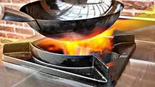

I had a chance recently to measure the power delivered by a reasonably high power gas burner. A professional Taiwanese chef was using it to cook egg fried rice, which everyone agreed tasted delicious, so I am going to assume it was of sufficient power.
I placed 500g of water in the wok and let the temperature equilibrate for a few seconds, then measured the temperature. Then I put the gas burner on full blast for 10 seconds, then switched it off and let the water equilibrate again for a few seconds.
The initial water temperature was 22.8ºC. After heating, the water was 44.3ºC; a rise of 21.5ºC.
The specific heat capacity of water is 4184 J/(kg K), meaning that approx 45 kJ of energy had been delivered to the water, over 10 seconds. Or 4.5kW of power over that period.
Most consumer induction hobs only seem to go as high as 3kW (presumably measured on the wire, and not as actual power delivered to the wok) so probably aren't delivering as much power as this gas burner.
However, some commercial induction hobs designed for woks, like the Target Catering Equipment range can go as high as 5kW. However, it's not clear if that's the maximum power consumed by all the rings together, or the maximum power that a single ring is capable of.
In conclusion, consumer induction hobs aren't far off the power, but don't get as high as needed, but some companies may produce hobs with enough power.
